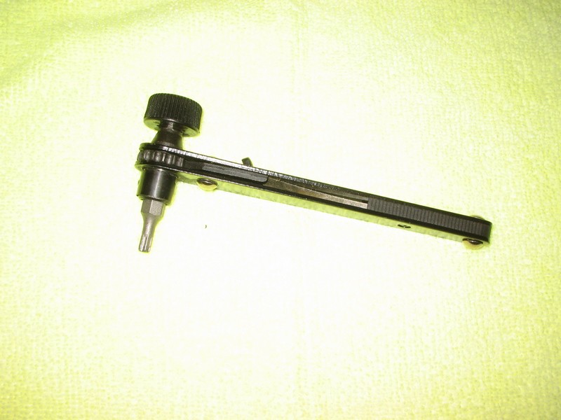

It's a T20 Torx bit you need, and it is easier if you use an offset ratchet to get at the screws nearest the screen:
No problem Richard, you will both get credited!

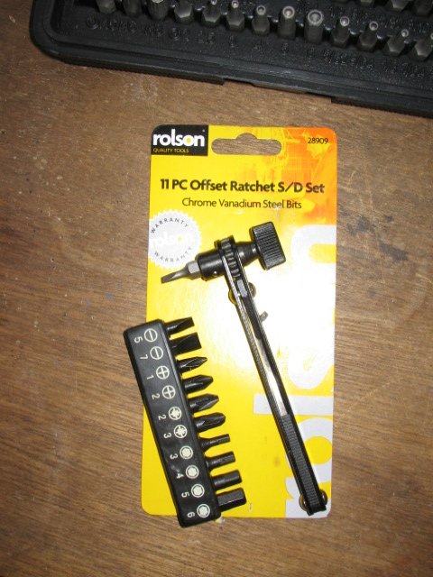

Where did you get that ratchet tool???
Has it got any markings on it like a part number and manufacturer?
It looks like one of those "I need one!" tools I see from time to time.
