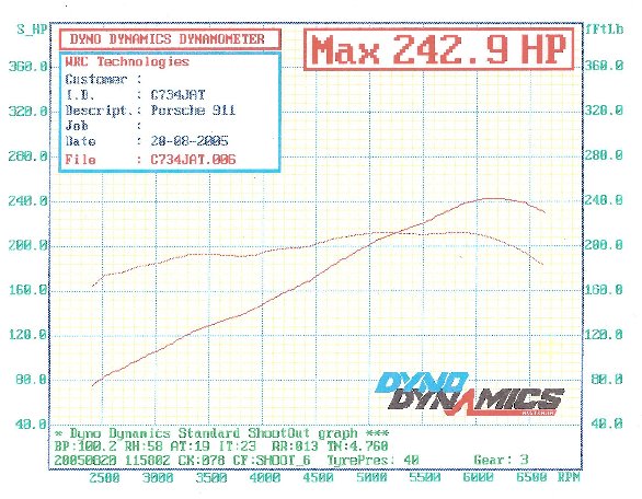

You can have power over 6000rpm with a bit of reworking, at the dyno day mine was peaking at 6300/6400 before it dropped off, its been remapped to suit the engine mods, it used to rev to 7000rpm when i got it, but I have changed the rotor to cut-off at lower revs now. As Richard B states you can put a lot of stress on the engine. so be wary. Steve Wong as an excellent reputation in the States.

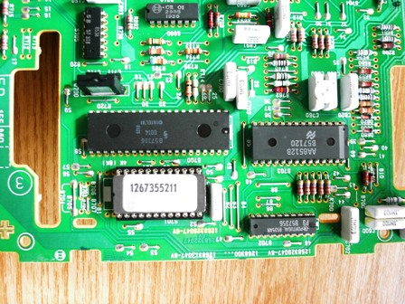

IanHighfield
You asked me to let you know what chip I have to make that 240bhp !!!!
The seat was a complete nightmare to remove, as the bolts had been slightly rounded etc. etc.
Never the less, here is the STANDARD chip picture - or at least I believe it is according to 911Chips.com
It is number 1267355211
Should I order a Euro 3.2 with Sports Exhaust chip ? Or do I send SW my dyno sheet from Weltmeister and seek his advice ?
If I go for something like the FVD MAS (!!!) in the future would I need to re-chip ?
I will get an order in soon and let you know how it feels - any idea on BHP it will now make ?
IMHO, the best advice is to mail him your BHP and AFR reading. He will then return you a custom chip which will not only be optimised for WOT (all you ever test on a dyno) but more importantly, will contain his custom code for part throttle acceleration
Steve (and all other re-mapping companies) need to understand what induction, engine and exhaust mods you have made, and also whether you intend to run on 98RON fuel or not
FYI Steve got the AFR ratio 100% spot on for one of my earlier re-maps once he got the AFR. Literally perfect.
