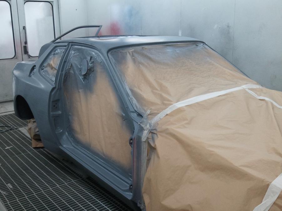

This picture was taken an hour ago and the man with the spray gun was in the next room waiting for me so he could start. She should be all red now. Will have three coats by 9 tonight. Then sanded and finished with a clear coat by the end of tomorrow[:D] After that the re-assembly begins. I've seen some photos with the car all put together and panels fitted, she finally looks right.[:)]
p.s. you can't see it very well in the photo but he's bought the original stone guard stuff used by the factory. Apparently only one place sells it now?
I thought it was a standard Wurth product? Paul Smith experimented with it IIRC, when he did some touching up on the S2.

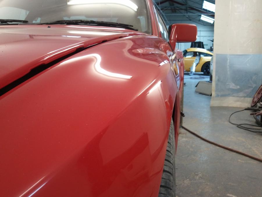

I don't want to show too much while she's still got the final lacker coat and blocking back yet to be done plus she's looking a bit dull now as its not been polished yet but.. this is what the finish looks like now on those rough fibreglass wings, and this is in the extremely harsh inspection bay where WUF originally looked like a right hash of swirls and imperfections (I thought it looked immaculate under normal light outside?!)
Now there is nothing, not the tiniest pimple, swirl or change to disrupt the reflection. Just a perfectly smooth surface.
Lighting makes a huge difference to the degree of imperfections you see, and the quality of the finished article. If it's that good under harsh lighting let's see it in the real daylight!

I can't wait to see it all finished. If it's as good as Ben says it is then it will be real good to know of a good shop in Northampton that can take on older cars with corrosion and maybe do a bit of fibreglassing at the same time [:)]
Ben, just to clarify, you have replaced the old OEM metal front wings with new f/g ones? Is that the only material change? I'd be curious how much weight you save by just doing that? Don't suppose you know the weight beforehand?
I've got a weight slip somewhere in the history file, rather heavy according to Rick but I haven't seen it yet. I've changed the wings and the badge panel to fibreglass (just the bonnet left now up front) but although this may sound silly there was a lot of paint on the car, some areas were really thick. I reckon that will have an effect on the figures now its been taken back to bare metal all over.
