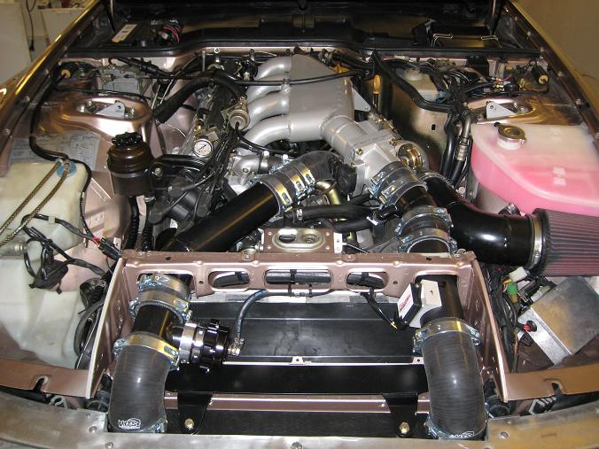

For what it's worth I noticed a significant reduce in oil contamination in the intake since I fitted an oil catch can. Mine doesn't vent to atmosphere though, is in closed loop with the intake.
Me too actually, and mine also recircs, but I do still get oil in mist on the intake pipes, just takes longer to form - think a catch can is well worth having just because of the metal pipe under the intake. This gets full of carbon and rusty scale and if any comes loose it goes straight into the turbo intake with the standard set up.
I dont actually have any experience of it but I remember one of the criticisms of K&N and similar filters is the oil can destroy hot wire MAFs - the internet wisdom is oil gets on the MAF gets hot and carbonises destroying the MAF and if there is enough oil escaping a filter it doesnt take much. If its true its a shame as otherwise that cold filter set up looks great! And with the MAF there you get air temp after IC as it goes into the engine, which I guess in the standard position there is a carefully calculated 'guess factor' as to how efficient the turbo and IC is.
Tony
As an example the Vitesse MAF kit includes a K&N cone filter so I would guess this particular MAF sensor is not much "excessively" prone to failure because of the oil of the cone filter. As far as I have noticed, Bosch MAF sensors are apparently another story.
Others went for a similar set up and didn't seem to have met any issue, though they might consider normal to inspect/clean the intake regularly in order to avoid any issue.
(Eventually I would like to move the MAF there in order to make proper 4" piping in front of the turbo which has a 4" compressor cover)
That's an interesting topic on the oil catch can possibly producing excessive back pressure. Does anyone know the size of the hole you need to the filter to prevent this? I'd like to check mine, I know what happened to a previous car when my sump breather pipe got restricted it resulted in 1 very oily engine bay and many blown oil seals!
Is this your car Thom?
IIRC enlarging the hole in the air/oil seperator (part of the oil filler plastic) helps
This has already been done on the advice of a Porsche technician well known to this forum, I was also told that the breather system on the 944T can't cope once you get over 350bhp and needs modifying, hence why the hole has been enlarged, I intend to look closer at the breather system in the future when time permits.

Hi Ben, as you know I have been on holiday but your earlier posting has puzzled me throughought and so I must ask someone to explain to me how the intake temperature ater the intercooler is much lower than the ambient temperature?
Air in the inlet sytem after the turbo is at a higher pressure than it entered the turbo - so quite apart from the heat from the turbo unit - it must enter the intercooler hotter.
The only way I know for the ambient air to cool the charge temerature lower than its own temperature (well it can´t inside the intercooler and temperature gradients accross different materilals mean it must still always be hotter than ambient) would be if the pressure dropped after it left the intercooler at the place the temperature is being measured. But this seems unlikely if it is to enter the engine under positive pressure? especially as the dimaters of the various pipes don´t seem large wnough to affect a temporary pressure drop anywhere. Is it because the venturi effect at one small diameter, just where the temperature is being measured has lowered the pressure as the air flow speeds up?
However to achieve over 100% volumetric efficiency (which from the outpùt it does) the pressure must always be higher in the engine?
I am sure there is a logical explanation and I am just too much in holiday mode to work it out - but it is releative to our discussions about my plans for the intercooler on my next engine so it is niggling me and I would like to have it explained.
