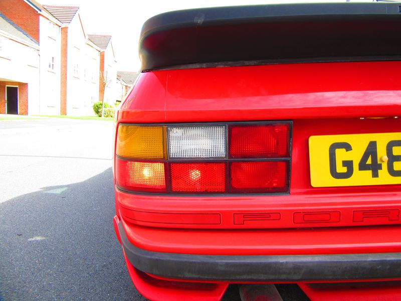

The Headlights use Halfords superbrights with the Rennbay wiring kit.
Indicators, front side and stop/tail leds are from Tore Bergvil as used in his 993 kits.
Stop/tail was achieved by using a double filament socket from a VW T2 Bay in the brake light socket
Pic shows tail lights only with a less than ideal led in inner position
