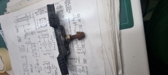

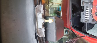

Today I replaced my hatch pins and mounting blocks
The pins were seized in the blocks ( not the block itself but the threaded block within) and thus couldn't be easily adjusted, nor could they be removed from the original mounting blocks. I had bought new blocks a few years back in preperation for the upcoming respray so only needed to buy the pin kits. Good job too, IIRC those blocks weren't cheap.
The blocks are held to the hatch frame by two csk allen head machine screws which were easy to remove. I did hope to renew the thin rubber seal which runs between the blocks under the hatch but all the screws bar two are seized solid so left this till another day, perhaps best done when at my son's with his vastly superior tool kit.
After some trial an error checking for how tight I could get the hatch to close, I settled on a measurement of 24mm between bottom of mounting block body and top of the pin taper end.
It feels good, 23mm was too close resulting in poor holding down of the hatch.
Pictures of before and after
