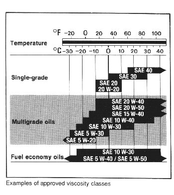

- the first figure in oil grades (e.g. 10 as in 10W60) is the capacity of the oil to make for "safe" or "motor-friendly" start ups in deep sub-0°C environments - see post above with the scan of the 944 owner's manual : A 0 figure is relevant in polar environments only.
- the second figure (e.g. 60 as in 10W60) is the capacity of the oil to keep its properties when it's "hot" - namely when the engine has been running for well over half an hour and is being happily revved on a circuit, for example. This IS what matters on a 944 turbo engine, as when it's hot the turbo needs as much oil as possible to function without being damaged. The thicker the oil, the better for the turbo axle. Oils with a low second figure (Mobl1 0W40) will be less viscous/more fluid than one with a higher one (Castrol RS 10W60), oil consumption will be higher and the turbo is much more likely to get damaged.
