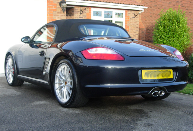

Kish - I appreciate your opinion - but I have a different one.
First thing is what is it you're polishing? If it's a daily driver and you want it to look nice - they're all good. But for long term paint protection I, personally, have found excellent results with Zymol and Swisol.
Yes, it's a lot of effort to get it right the first time - but maintenance is easy - wash the car off, then apply Field Glaze and buff off - here's one of my cars that's had seven coats of Zymol - done over five years ago and only needs touching up with Field Glaze after each wash. It's personal preference at the end of the day - and depends on what result your after:

What a gorgeous car! [:)]
Please post some more, or put some in the gallery. I love the old 911's!
Sorry, off topic, but had to comment. [;)]
