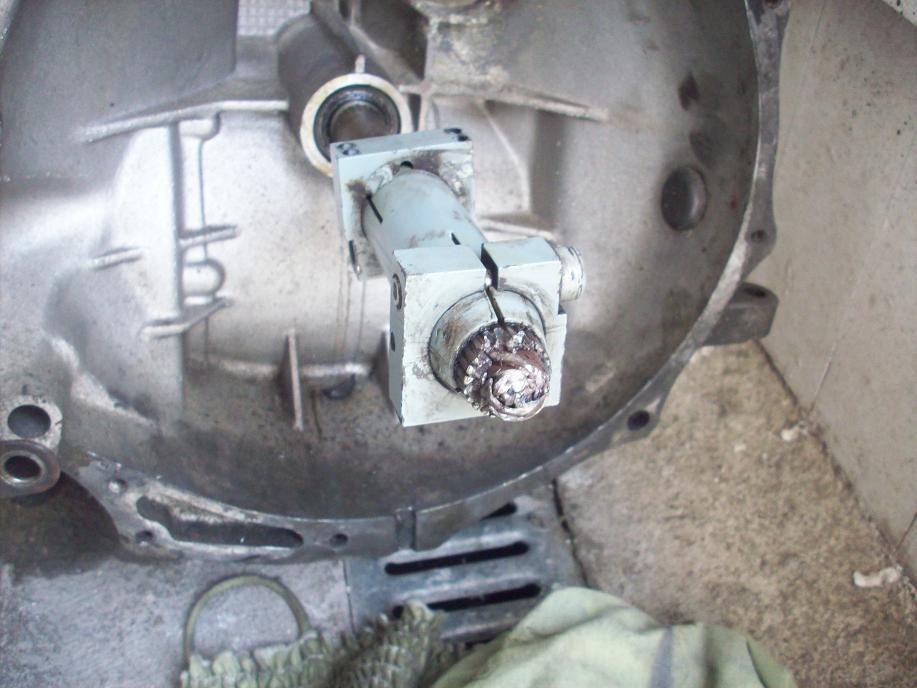

I thought the torque tube was a solid shaft, it looks like its a bunch of cables like a thick steel wire. Is it just the splines I'm looking at?
Would it be hard to get a stronger shaft for the torque tube made up?
The torque tube is made up from a hollow tube in which the shaft itself is held in by bearings along its length....the shaft itself is scarily thin when you actually look at it!
Sorry I mean't the torque tube shaft rather than the housing. What is the shaft itself, it looks like almost like a cable. I was expecting a solid or hollow metal shaft.

...The only thing that would concern me would be the drivetrain. I'm running 420 bhp as you know and having ( only 420 bhp ) power under my right foot I mangled my torque tube...it literally shredded itself at the gearbox end!!... Now....Am I just the unlucky one or will this be a regular event with that kind of power and upwards with the potential the LS2 has to produce? Would the drive train be beefed up in anyway?

The Shaft is a solid piece of metal...the pic looks confusing as its the splined end than locates into the gearbox and with the twisting effect it looks like a bunch of cables!
ORIGINAL: AndrewS
This is preferable to changing the properties of some components, but ultimately some components may need to be changed (testing on the track will provide that information). Your torque tube is almost certainly original, hence has done over 200,000 + miles and all the track days I did from 1997 to 2004 (at least 30).
Hi Andrew - I'm glad you confirmed the torque tube is the original. It makes sense now and considering the mileage, track days and power it's well past its best....It has got 220K on it so cant really complain
I will pm you private regarding getting a rebuilt one...I'm not so keen on putting a second one in of unknown mileage etc...its a big enough job and dont want to be doing it again anytime soon!

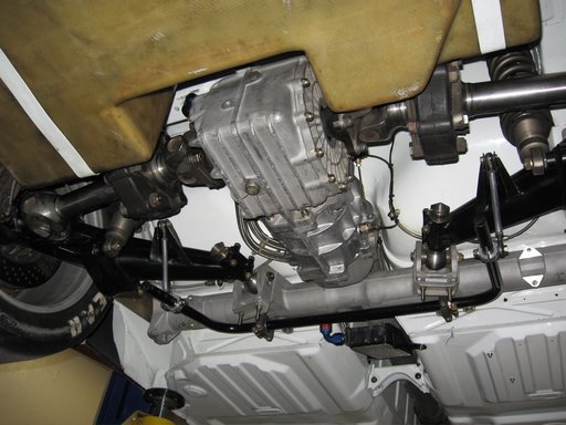

IIRC, I read somewhere that the factory retained the standard Ø25 drive shaft for the 924 Le Mans prototypes (16v 400+hp), thereby retaining the std bearings and keeping weight to a minimum.
How did it survive? Rubber donuts - integral to the drive shafts between the diff and the wheels to absorb impulse loadings.
Andrew, excuse my ignorance but what is this PCM you refer to? Porsche 'C' Mgmt...
Are you installing some sort of traction control too? So for 20k you get the LS2 installed drive away and with a warranty? What other 'refurbishments' are included? Does this not include the cost of the car as well or is the customer to provide their vehicle?
Oh, not sure about the actual torque tube design of the 924 Le Mans racers, but here's the transmission and axles. Note how much beefier they are from stock. Makes you think....

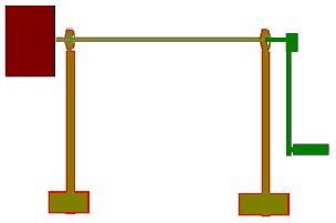

Ummm, why would this help? Given that the component giving concern is the torque tube, and this is between the engine and the gearbox, limiting the engine torque in any one gear won't help. It is subjected to the full torque output of the engine (at full throttle, naturally), no matter which gear the transmission is in ...

Hi Oli,
Best way to explain is as follows:
Imagine you have a wooden shaft with a handle at one end and a large heavy weight at the other end. The wooden shaft is supported at both ends by mounts and will turn freely (see picture)
If you violently turn the handle, the shaft may snap. If you turn it more gently and then gradually increase the speed and force with which you are turning it, the weight will turn and the speed of the weight turning will increase. When the weight is turning quickly and you increase the force at which you are turning the handle - the shaft will not be as stressed as if you attempt to turn it with great force when the weight was stationary.
This is the principle of torque management which can be achieved electronically.
Regards,
Andrew
I would also add (apart from my little picture looking a bit like a K9) that's why drive shafts get such a hard time when racing (and why big rubber donuts are sometime used to absorb the twisting forces applied to them).

Essentially are you limiting how much work is done on the shaft itself? So to take your handle with the fixed mass analogy, when you spin it quickly a lot of the work you do is twisting the shaft rather than spinning the mass due to overcoming the inertia of the mass (it doesnt want to move to start with).
I should also have added that limiting torque in specific gears could safe guard the driveshafts. Specific RPM torque limitations could be required to possibly reduce the stress on the torque tube assembly.
