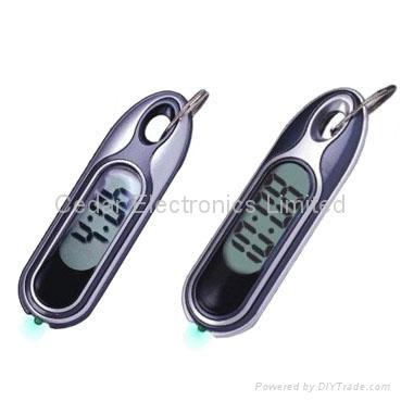

just a thought; anyone tried to hack a small cheap lcd clock? if you could do it without destroying anything it could give you a working clock that you could restore in future to standard spec.
eg;
Richard,
It depends upon what you are trying to achieve. Something to fill the hole in the dashboard? Bit of black tape will work. A useful clock? No need for one - there is one on my radio.
Oli.
Ah sorry i was thinking it was a cheapish working clock you were after.
Thats just how my brain works tho; for example I have a space invaders arcade machine; rather than replace its 1978 corroded and broken innards with equally unreliable old technology i replaced it with a modern PC that runs an emulator. I wired the controls and coin mech to the PC and I did it without altering any of the original parts so I can restore it if needed. Nobody can tell. It even takes old 10p pieces.
LCD clocks come in all shapes and sizes; you can pretty much pull them to bits and put all the parts in 2-3 square centimetres of space. They have long lasting batteries and a lot have transparent panels. Invert the voltage to the panel and you get the 'white on black' display that could be backlit using the existing bulb. Id probably replace the bulb with an LED and stick a slightly opaque filter on the back of the panel to diffuse the light, do this in orange and you'd recreate the original glow.
I dont know what the space constaints are behind the dash but its something I'd consider and its no better or worse than getting something from a different car.
Richard,
'Twas a good idea, to be sure. And one I had considered. And yes, it would be a pretty easy solution - the amount of space taken by the old clock is massive, and seems even more massive when you see how small digi clock mechanisms are. But I guess I am relishing the challenge (sometimes!) and really like the original solution. If I put a different clock in there, I know I would look at it on a regular basis and regret it! Loss of the stopwatch is probably the thing I'd miss most. Not that I have ever used it, just that losing it would seem a retrogade step to me.
