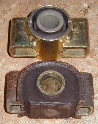

So you've posted a pic to show that the 944 mount looks like the king of the space invaders, whereas the 968 item is a simple drone? [&:]

Here's a pic comparing my old and new (much better than the other pic [;)] )
I'd say different, not better [:D] [;)]

Graeme had several attempts at this ~ his first is shown HERE [:)]
(whisper mode) You can see the difference in "pivot height" that I mentioned previously in Graeme's pic, but don't tell him. ( / whisper mode)
