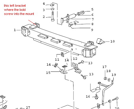

I've just stripped my car (front and rear bumpers off and dismantled them, taken the side skirts off etc etc, and taken the left rear window out) as its off to the body shop on Tuesday for it rust spot on the rear wing and lower screen, and as part of the work I had to replace all 4x of the rear brackets ..as they fell apart (fully Hammerited the new ones before they go on )..
(FYI : The rear bumper reinforcing bar fell apart at its mount so another one will be required as I have no mount now, all the UK breakers tell me these are hens teeths...OPC price over £550!! so plan B, I found one in Europe 2ndhand at 200euros+shipping)
Has any one checked the two leading front brackets holding the front wheel arch to the body ..its just behind the front of the front inner wheel arch .....10cm long with a small bend in to ....£50+vat each !!!! and I can guarantee if yours are original, yours will be shot as well ...and Porsche know it !!!! the only positive thing is at least you can get them as Genuine parts, if this was Ford no way.
I've also made a rear left hand inner arch protector to stop all the grud going up inside the rear wing .....i'll have to see if it works now....as I might look at selling a few on ebay. Right hand one is a lot more trickier but will look at that later.
Today's cost for the Porker due to corrosion/bad design is the rear bumper reinforcing insert. The one in the breakers that I was promised to be in A1 condition was utter rubbish and was just waiting to fall to bits, and he wanted £150+vat....so it was worse than my one that when disassembled fell apart after waiting to fall apart. So as these are Hens teeth in good condition as there all like this on the left side, I had to bite the OPC spares bullet ....£550 later retail !!
So if you looking at waxing your car perhaps put some on the left rear inner bumper alloy mount as I suspect if you look carefully the alloy will be splitting and waiting to falling apart under the wet and hot damp atmosphere..funny that Porsche have two in the shelf in Stuttgart ...well only one now ;-)
Ian, any pics of this part? I'm struggling to picture what you're reporting to us.

Two pictures ( one at a time due to site restrictions ) of what I've been mentioning ......take your bets as to the state of yours ..what might look OK on the left rear mount, at closer inspection falling apart.....but your only know when the bumper comes off and your see the alloy mount splitting apart ....worth knowing .
