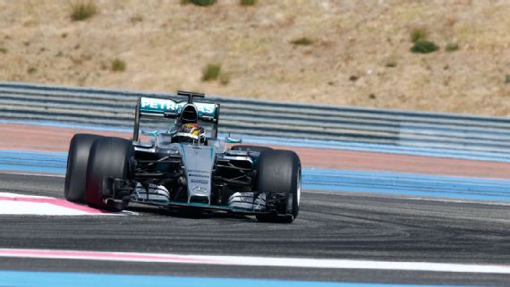

A Slight Variation on this Wheel & Tyre Theme (Bigger & Wider) is next years F1 Regs are up for a
big change in Wheel and Tyre width and also more Aerodynamic downforce, which they predict these new car's will be 1-5
seconds faster in lap times compared to this year...
On very fast (straights) tracks like Monza it's said that such is the extra Drag of the Wider wheels lap times
will not be that much quicker than this year, but on other slower and tighter circuits the extra downforce and
rubber molecules will provide faster corner speeds.
This Picture clearly illustrates, a lower narrow chassis with 4 HUGE lumps hanging off it! No wonder the Drag is a big factor.
