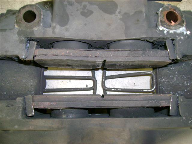

The front calipers were removed and the plate lift was v v bad. The plates had to be replaced although Andy tempted me with a big blacks deal but I have a limited budget [&:] One 44m piston seal required.

Rear callipers had (guess what) plate lift, one ok the other the bl**dy screw sheared so a refurbed calliper required [&:]

Looks like you had some proper plate lift there......
So your brakes will also be great..
