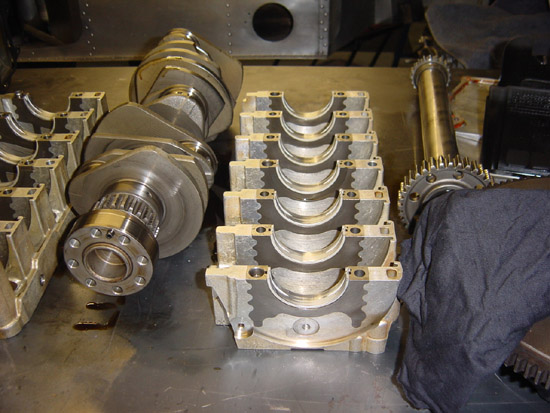

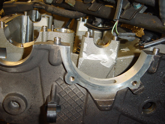

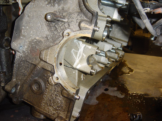

I went to see the engine today which has now been dismantled. We have seen some evidence of damage to the crank block in the form of striations in the metal, as if something has gouged out some of the metal. I'll try and attach some photos dependent upon file size, to show enough detail to illustrate this.
We also noted that the composition of the two halves of the crank block were different in profile. That is to say that the block comprises alloy with steel inserts but the profile of the steel inserts differs between the two halves. The two halves are stamped with the same number "1173". Again I will attempt to attach photos to illustrate. Any comments as to whether the difference in the steel insert profiles are normal or not would be appreciated. There are also cracks between the alloy and steel sections appearing in some parts of the block. These should be evident in the photos.
