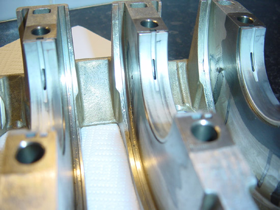

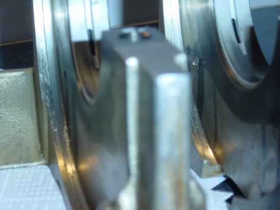

I made another very useful contact yesterday and took the faulty crank cradle to show him. He noticed that the metal was flaking off one part and I've attached two photos to show this. I'm now more convinced that the metal that was found in the sump was off this particular part. Whether it was the cause of the misfire we'll never know but I think it stands a chance it was based on the OPC's previous experience of swarf affecting a new 997 which resulted in a moving misfire. He also said that the grind marks in my earlier posts would definitely have been done at the factory. It looks like they were trying to grind off some material from the casting process.
Also you will see from the other attached photo that another part of the cradle is showing fractures in the surface metal which I'm sure in time would have gotten more severe and flaked off as well.
My thoughts are now that it's probably a good thing that the engine was dismantled to discover this. If it the msifire had been identified and cured without engine dismantling, more metal could have broken off and caused a major engine failure whilst I was on the motorway or other fast road.
