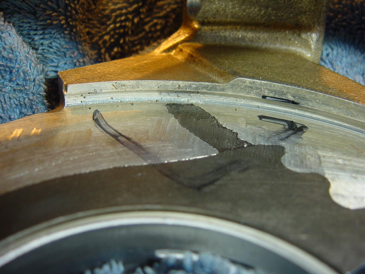

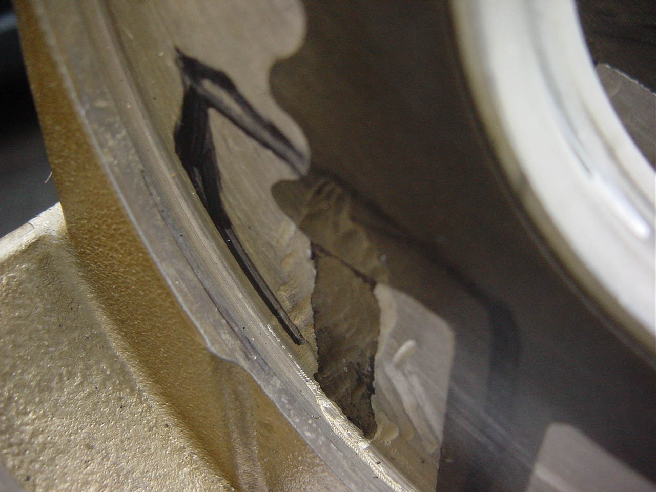

I also sent a lengthy letter and 13 other supporting photos showing the grind marks in close-up and more detail and a further imperfection in the bearing support metal to Customer Assistance (now there's an oxymoron if ever I heard one!!!) in Reading today. I quoted the Sale of Goods Act 1979 and stated that the marks on the crank cradle could only have been done at the point of manufacture or assembly and certainly before the car's normal lifetime began. I also pointed out that only areas that had cracks in showed signs of grinding. Hence the part in question was and still is, not "fit for purpose".
The photos I included clearly show ancilliary marks left by a grinding tool on the curved parts of the crank cradle section involved. (Example attached).
Their attitiude was that's just your opinion, prove it and we're not changing our decision. They invited me to get an independent inspection done if I wanted to pursue the matter but there would be no guarantee that they would change their decision.
They suggested I contact the Institute of Automotive Engineering Assessors www.iaea.uk.com for an independent assessment. The assessor I eventually talked to said that I'd be better off contacting the Institution of Mechanical Engineering as my situation was more metallurgy based than the situations the IAEA advise on.

The RAC have agreed that the cracking and fracturing are abnormal and not down to normal wear & tear. They will provide me with a report (cost around £140) to send to Porsche GB with their conclusions. They suggest the next step would be a metallurgical examination (industrial x-rays etc.) to determine the nature of the cracks and fractures. I think it's worth getting The RAC report anyway as it would assure future owners (if I sell at some point in the future) as to why the engine was changed hence helping residual value.

Metallurgy specialist has confirmed evidence of porosity in the crank cradle. Photo attached showing small holes/indentations in the alloy. Porsche GB informed today.

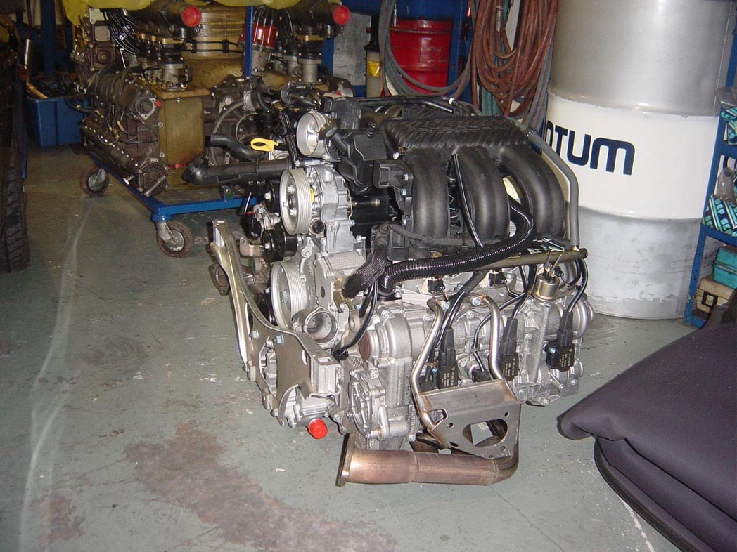

Hi JC , make sure that whenever the new engine is being built up that all the fuel injection parts are well inspected because you have just spent an awfull lot of money but have yet to find anything at all related to the missfire. Make sure the engine has new coil packs fitted!!!Good Luck.
Thanks for your reply.
I went to see new engine today. Coil packs all there etc. I've got the new coil packs we put on the old engine as well as part of the cure process, so well stocked on that part at least.
Hoping to be back on the road end of this week/early next. Also got advice from OPC re running in suggestions.
Rgds
John
That looks pretty complete. No alternator or belt by the looks of it. What other parts do you have to take off the old engine? Does it include a flywheel and new clutch, for example?
Hi Richard,
I believe I'm correct in saying that you use the original flywheel or replace if necessary and original alternator. New belts will probably go on as well for max mileage without any concerns.
Dave and Ben will be pricing up the final spec so I should know in a couple of days or so. As it's Tiptronic I don't think there's any other impact gearbox wise etc.
