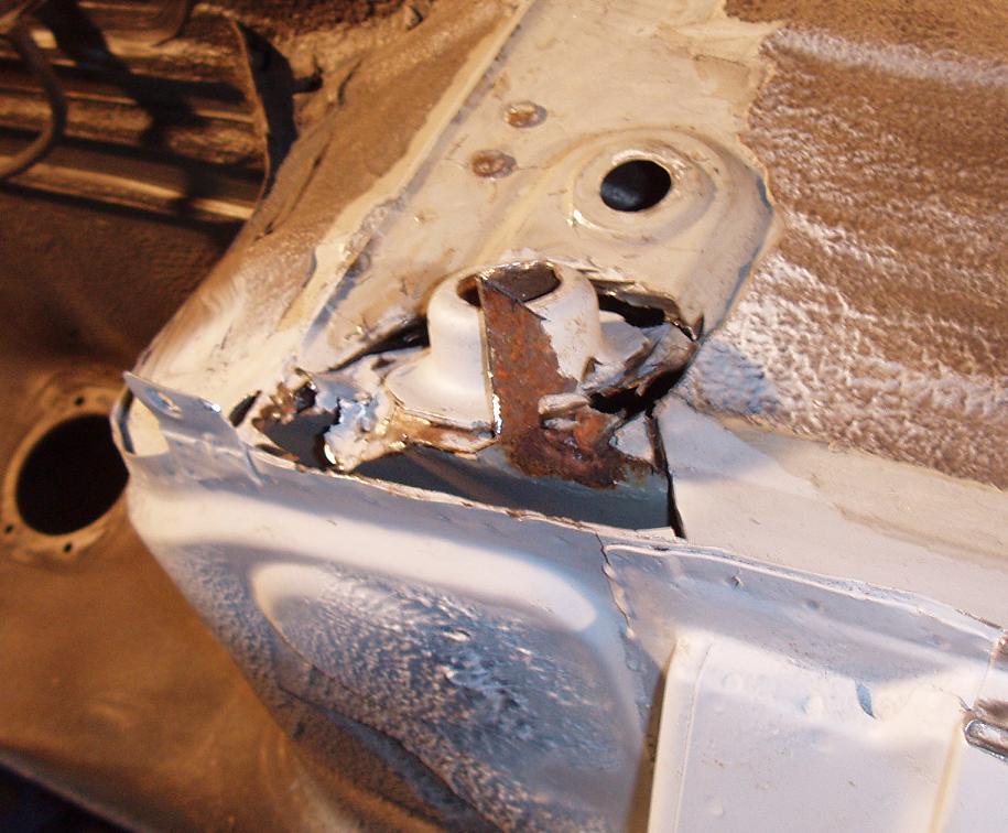

Alan has made fantastic progress with the offside, in fact it's almost completed:
The new sill looks great too and the floor has been repaired in patches where necessary. Note the complete removal of all the bitumous panels from throughout the car, in fact the only sound deadening will be the carpet, I may live to regret this... [
The new fibreglass bumper is being test fitted and it's not too bad at all considering it's probably intended for a race car, I like the nice clean look too. Think I will probably have to do something with the exhaust as it's a twin exit design that was modified into one to fit through the old toast rack valence, I think it will look a bit odd if I run the rear nude as I intend [
The next job is to get the nearside done:
This is much better than the other side (I know it doesn't look it!) and will be quite an easy job to put right apparently. The windscreen is coming out at the weekend so the rust around there can be sorted.
Alan thinks it might be primered up fairly soon (possibly as soon as next weekend). He's found loads more holes in the interior to weld up (I wanted the noisy ones that the rear seatbelts would have located into done) and will be getting my pet hate sorted - yes, those nasty roof rack bolt holes are going! [
