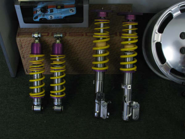

O.K .... dont know if this question has been asked before but cant remember and theres way too many posts to read them all again and i need to be clear on a couple of things.....is the KW V3 a direct replacement for what i have on the car now ? besides the reindexing and 4 wheel adjust ments is there anything else i need to purchase to make the KW fit ? and will the KLA top mounts fit directly to this kit ?
Thanks for sticking with it guys.....[:)]
ORIGINAL: spic01
...and will the KLA top mounts fit directly to this kit ?
Do they come with their own top mounts? I think the race versions do, but I'm not sure about the V3 setup...
Karl.
They come with a purple polyeurethane spring hat, but I can't see how it's much use to a 944

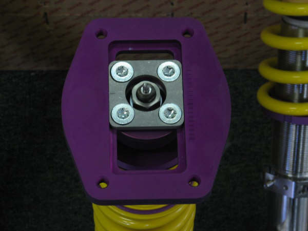

If one did go with KW, which aftermarket camber-plates are known to work with the front struts?
Thanks.
Karl.
Karl, KW make their own. They call them 'Racing Top Mounts'.
Hiya,
Thanks for the info.
When I contacted Tom Edge at KW USA (back in Feb 2007), they said the "racing top mounts" were not available for sale in the US. For the heck of it, I've just sent him another email to see if that's still the situation.
Karl.
