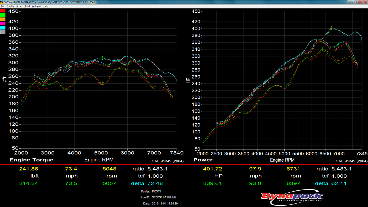

Some further performance upgrades for the 981 GT4 engine from the USA. Dundon Motorsports have developed intake runners and claim an additional 100whp when combined with their other performance upgrades as follows:
1. Race Headers: our design provides a stronger suction wave than other designs and is necessary for the intake runners to perform optimally. 2. GT3 Muffler Adapter Kit: The stock PSE becomes a restriction above 380whp or so and the car really starts building heat in the cylinder due to the restriction. Our kit also allows you to add cats back to the car so you donā€™t have to be catless. 3. Cobb Accessport with our pro tune 4. Intake runners/ IPD Plenum/ GT3 TB: The last bit after the above mods are done, adds power where the car needs it and shifts the resonance peaks up as well. They have posted the dyno graph below on rennlist
Middle is Dundon Race Headers+Pro Tune
Bottom is Stock GT4
Top is Dundon Race Headers, Intake Runners, IPD Plenum, GT3 TB, GT3 Muffler Adapter, Pro Tune
In another thread, an Australian poster reported they could not get much of a power increase over stock after fitting the X51 Powerkit* (with 82mm throttle body) and applying a tune. They then replaced the multi-valve X51 plenum with an IPD plenum and got a significant increase in power. Is the IPD better than the X51 plenum? I'd guess unlikely and their issue was not tuning the valving correctly, but who knows for certain.
* Consists of new (gas flow improved) heads, camshafts and multi-valve plenum + remapped ECU
