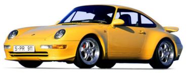

I'll post a pic of the ones I have an eye on when I find a decent picture. They are similar to the Cups 1 but have a groove in the spoke, I have seen them mostly on 993's but in split rim form.

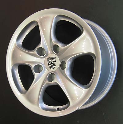

I was originally after some cup 3 alloys to replace the original teledials on mine but came across some 17" Boxter wheels at a good price so went for them instead. They are the 5 'swept' spoke style (sort of similar to the cup 3's) and I think once on the car they look just as good. I've attached a photo but unfortunately it's not a great one that show off the wheels.
I've not seen many other 944's with them fitted and they tend to be cheaper than the cups since they are not as popular.
However I don't think they do them in 18" if that's the size you're after.

Those look like "993 Cup 2" wheels. I had a set (non-split rim) off a 993 on my 944S. They looked great!
The fronts (7") are a little narrow compared to the back (9") for a 944 though. Could have done with 1/2" more width on the front.

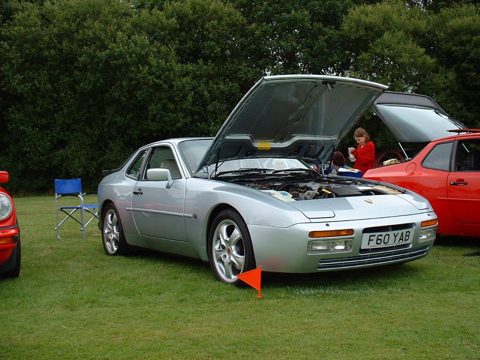

Or something a little different - I don't know what size these come in as the web site I saw them on seems to have gone a bit gibberish.
This might give you an idea (although the pic doesn't look quite right - may be because there's no disks behind the pic of the wheel)
Here's a real picture of them - not my car I hasten to add, it belonged to a guy called Steve Bright at the time and it won best visiting car at the Devon & Cornwall concourse 2001. Personally I have to say I don't like them.
