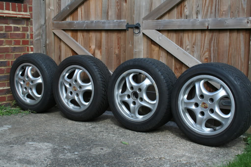

I have a set of 16" wheels on my 944s at the moment, dont know what 'name' they are though. Good tyres all round.
Yeah they're cup 1's [:(]

As mentioned previously these aren't mine, same wheels though with all centre caps
Yes theyl fit, BUT the rears could be very tight on the passenger side arch...[under the compression of the suspension].
Should be ok on the drivers side, but for whatever reason a lot of the cars, be it S2,s or turbos made around the 89-91 years have slightly different clearances from the drivers to passenger sides, only on the rears though, so be prepared to do some arch rolling....
