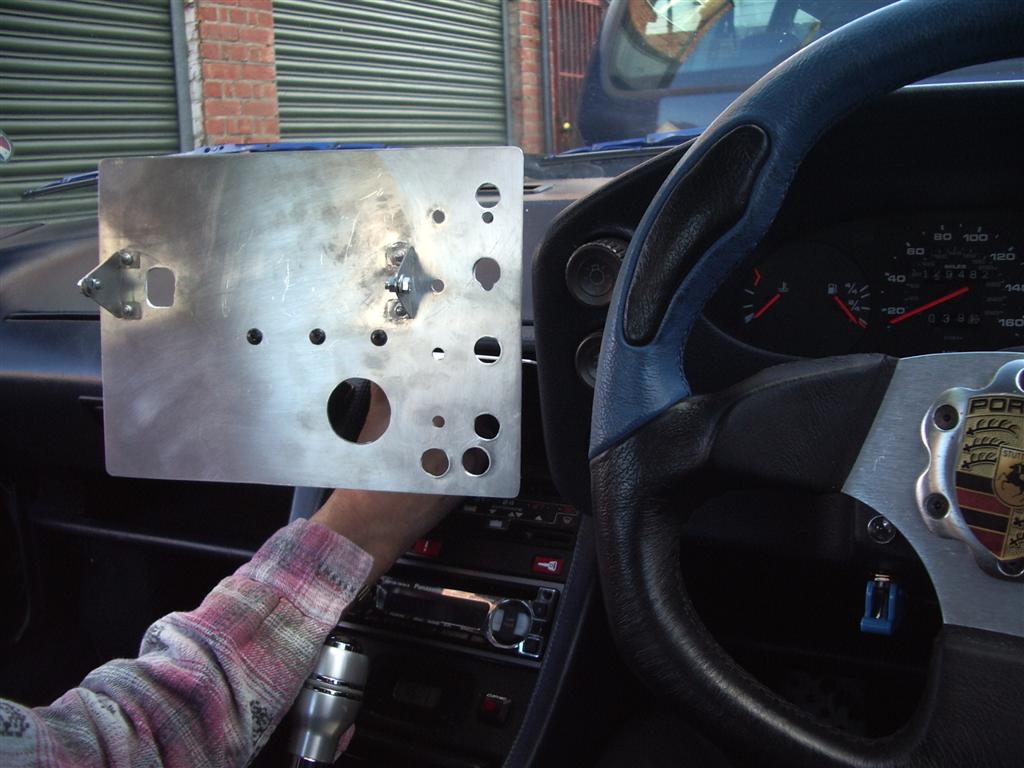

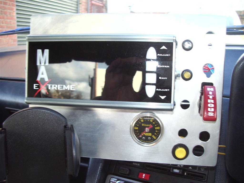

Hi All :)
Ally plate now mounted in car...
Maxx Extreme Race controller ...
Nitrous Pressure gauge ...
Arming Switch ...
Horn ...
Couple of LEDS ..
More switches and laser LEDS to fill other holes to come...
Then more wiring in etc...
All the best Brett :)

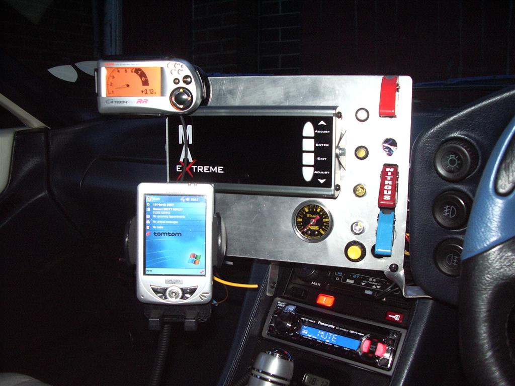

Hi All :)
Did some more wiring so another piccy...
Top left = G-TECH accelerometer (reads 0-60.1/8 time...0-100 etc etc etc)
Bottom left =Sat Nav as G-Tech wont read above 150 mph lol
Bottom right switch...kickdown bypass
Second switch ....Nitrous Arming Switch
Top switch and hole for other switch ...bottle heater controls..
Nitrous Pressure gauge..should read 950 psi while running Nitrous...
Next stage....finish wiring plate , then move to back of car and replace my single
11 lb bottle with twin 14 lb bottles...total 28 lbs for high speed runs WITHOUT pressure drop...
