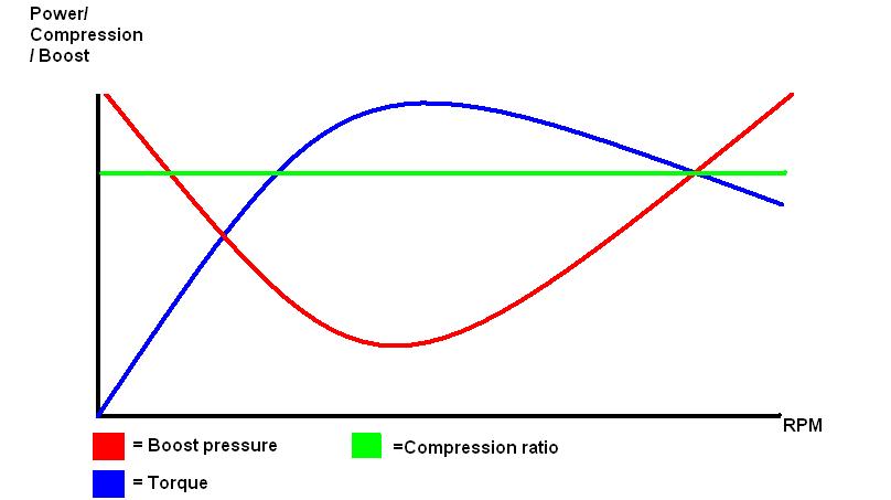

Surely as a turbo has the ability to lift C/R a much simpler solution to altering the stroke of the engine (and all the complications relating to that) would be to have a C/R somewhere between that of a regular turbo and N/A engine and use a sequential turbo setup controlled electronically to give a boost curve exactly opposite to the engines natural torque curve.
Yes, this has an effect to a point, but is only a half-way house when used on it's own. This will determine what force is produced onto the crown of the piston due to expanding gases, but how you use that force depends on the mechanics of the moving parts of the engine. For example, if you have a constant force but increase the radius arm it acts on, the torque is increased at the pivot - so same force acting over a longer distance and more torque.
Surely you could adjust the boost in this way to improve any engines natural characteristics be it natuarally high in torque or hp? Maybe my understanding is worse than I thought? Not being sarcastic, genuinely curoius as to what I might be missing in my understanding of compression pressure. I understand that if the same pressure acts on a longer stroke, long crank throw more of its energy will be converted into torque but the rate of twist will be slow, I understand that on a short stroke, small crank throw less energy will be used to turn the same rotation but it will turn faster so higher bhp but less torque. Are you saying that the piston applies less pressure on the gasses in a short stroke engine so the compression of the gas is lower? Or maybe the higher the RPM, the higher the C/R because the gasses are compressed faster so get hotter due to friction?
How does it change if you are able to get the same amount of fuel and air into the cylinder at all RPM's? - in theory

I do not have time unfortunately to get too involved in some of the discussions about crankshaft throws etc but it is obviously a good idea to have a variable control to the boost or waste gate or by a dual waste gate as a way of influencing the compression pressures at different revs and conditions - it is just that in my limited experience - if you have a big turbo, pipes and peak boost pressure there is still a lag in repsonse that I prefer to try and avoid - perhaps time will prove me wrong on this and it is one of the things we want to test. We will be trying to get the best torque curve we can with the next engine but the third engine we build will be the one we will try and combine the benefits of both of the earlier ones at each end of the scale.
It is a relativley short stroke engine anyway (104 * 88) and anything that alters the stroke also alters the capacity of course - so difficult to compare like for like.

If you are using a standard DPW setup I don't think you can open the wastegate any earilier than the natural boost curve allows. You can only put opposing pressure on the wastegate diaphragm to keep the wastegate closed for longer making boost rise quicker. To slow down the onset of boost you would need to have a pressure source indpendent of boost pressure to drive the wastegate open.
