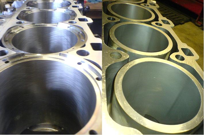

I am not sure I agree with the school of thought that the lined versus unlined gives you capacity to run more boost on larger engines....the bigger the capacity of the engine, the more air you can process, once you start getting into high boost (22psi upwards) you are asking a lot of such a big engine and will start to run into problems such as keeping the head on the block!
Normal 2.5 944 turbo engines can run in the 22psi range without problems with the right accessories and tuning and I am pretty sure my 3.0 can as well but much more than that and it wont be the liners or the block that will be the first thing to go. If you want to run ultra high boost you are better off sticking to the 2.5 the way I understand it?
The interlocking tops to the bores on Jons Larger capacity motors makes them much stronger. The standard bore has no support around the top I liken it to a saturn 5 rocket nozzle in my mind that flexes and changes shape at high temps and pressures. If you look at headgasket failures on engines that have been running high boost number 4 cylinder will usually have some polish marks on the fire ring. Also there were pictures of a few failures on rennlist where cars had been running high boost and water injection cylinder 4 cracks down the bore from the top. I believe that there are additional loads on number 4 that makes it move/crack first - not sure what though, the flywheel maybe. I dont think it runs hotter (despite being furthest from the incoming cool air) IIRC from rennlisters research number 2 wins that crown.

I had heard that before somewhere. Makes sense when you see the standard block. I struggle to believe that the 3.2 blocks will have lower boost limits than the standard 3.0 block?! It's not what Jon has believes even though he does not believe high boost levels are necessary.
I've also shown the pictures to a few engineers working whithin F1 who all seemed v.impressed and started spouting impressive sounding technical babble about the design and its possible limits (note to self must get an engineering degree!).

Here is a scaled down comparison pic between the standard 2.5 block and Jon's new 3.2 block aka LIL...
ps as for dangers of going that large with the bore size.. 8mm over standard?!! I take it your not a follower of the A-series engine? They take 1000cc blocks up to 1497cc leaving only a knife edge slither of metal between the bores! Loony as they are I know they do still run well.
