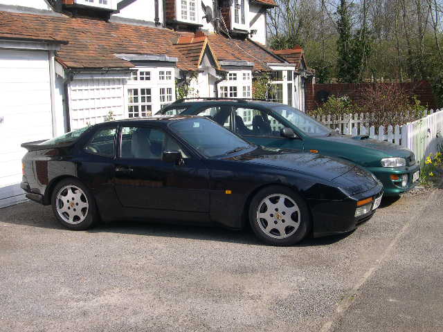

Below is a picture of my car with the KW fitted. The rear is not excessively high but is certainly not as low as Fen's. I am still running 16" wheels of course, which do not fill the arches so much.
You will need to lower the rear (re-index the torsion bar)

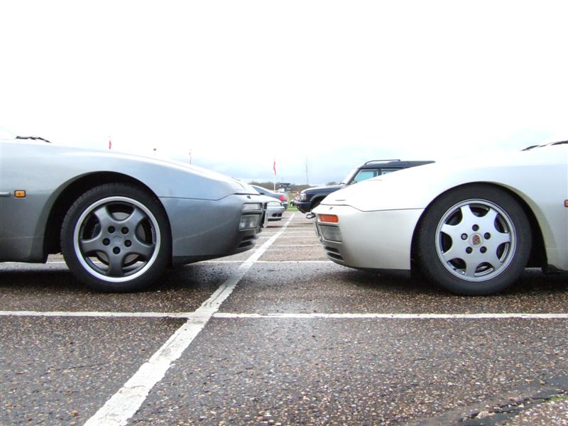

Here`s mine at the front compared to a standard car

Hello Fen, glad to see you`re back and contributing again.
To all considering KW, try a car with it first (Thanks Fen [:)]) You`ll then not go down another route especially if you truly intend to keep the car for a long period.
