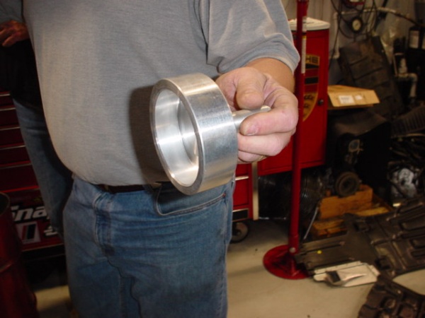

Things seem to be a bit different in the US.
A special Porsche tool part number 9699/1, came out over a year ago. Its purpose is to fit around the end of the crankshaft and into the RMS housing. The leaking oil seal is removed and then you try to push the tool into the housing. If the tool does not slide in then the crankshaft has moved out of alignment and is not centered in the middle of the seal. If the crankshaft has moved then you can replace the seal 100 times and it will do not good.
The M96 engine has a unique design.
The crankshaft does not spin directly in the crankcase, but inside a bearing case, which some people call a cradle. The cradle is held in place by being clamped by the two halves of the crankcase like a vise, should be a very strong design. However could it be possible for the cradle to move, which would then cause the crankshaft to become off-center just a bit. May be it has to do with the coefficient of expansion of differing metals? Surely it's not the way the engine was put together at the factory; it must be the nature of the design!
In the US if the tool does not slide on to the end of the crank then you get a replacement engine since the seal is not the root cause of the problem. Here in the UK, they just replace one seal after another. One assumes that Porsche GB receive the same TSBs from Porsche as the rest of the World.
Information and pictures courtesy of Jeff Lopez (Tool Pants)
