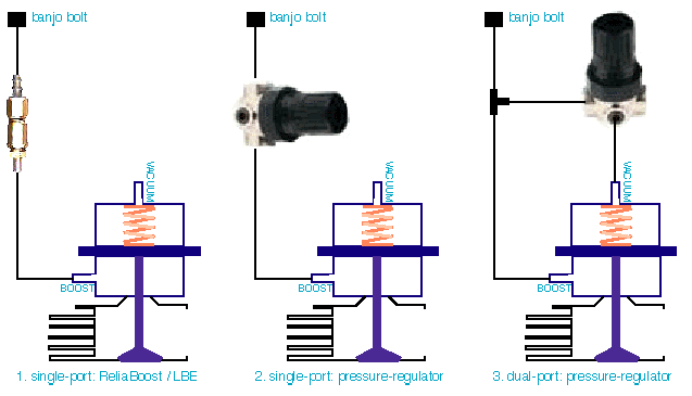

Here's the diagram that Danno posted regarding the three ways to hook up a TiAL.
I am going to use my Reliaboost in single port mode. Danno actually recommends this way compared to dual port mode as it produces less boost spikes. I shall plump for a 0.8 bar spring in the TiAL as that is the minimum I would ever run, and then control it up to 1.05 bar using the Reliaboost
I've got an Accuboost controller, I'm assuming that it's going to be OK to use with the Tial and if so which of the above three setups would suit me best?
Need to order one of these pretty quickly or I'm going to convince myself that I don't really need it :)
Tim.
I am fairly certain, no almost positive that the Accuboost and Reliaboost are identical in operation, but the Accuboost is easier to adjust. You simply twiddle the knob with teh Accuboost as opposed to loosen a screw and use two spanners like the Reliaboost
Therefore option one would be for you
Thanks for that Paul.
Based on the diagram I'm assuming that the top port is left open to the elements? If this is the case I think I might run some Purasil from it into a filter, or at least into the engine bay, to prevent crud ingress.

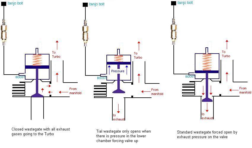

I think the tial is different from the standard wastegate in that it is held shut by exhaust pressure rather than pushed open.
I think this kind of removes the need for two ports to a certain extent, but what is the point in having 2 ports if you only use one?

Absolutely right, Tony.
The standard gate is just a really, really bad design where the boost pressure acts to open the valve. With a TiAL (and I guess the Lindsey one Andrew S sells, but I'm not convinced as I've never seen it actually stated, and the Lindsey's ports are the other way round) the boost acts to close the valve and an internal diaphragm and porting is used to open the valve when required.
That's my understanding anyway - the WG is just a regulator effectively and that's how they work, isn't it?
I wouldn't say a really bad design as the he standard (and i think Andrews /lindsey one) will fail opening early which protects the engine from overboost, the Tial will fail closed which could be quick but messy!
But yes provided the open signal is there as in normal operation it is a much better design.

As for the connection its just a matter of taking the pipe i have on the standard wastegate which is attaced to the Accuboost and poping it onto the side pipe on the tial leaving the top pipe to vent to atmosphere.

Ok I've adpted Dannos diagram to hopefully show why the standard wastegate is a poor design and what happens when the valve opens outward because exhaust pressure exceeds the spring rating and pushes it open. This gets worse over time as the spring weakens
The TiAL wastegate opens inward so it cannot be forced open by exhaust pressure alone. It can only be opened when boost pressure enters the lower chamber and forces the valve up. With no boost controller it will open as soon as pressure is greater than its spring rating. With a boost controller in place the wastegate should not open until boost pressure exceeds whatever the valve is set at.
What that also highlights is that because the standard valve opens downwards, even when it is open it still has the valve head "in the way" whereas the TiAL pulls the valve head up to fully open the port into the exhaust system.
Basically 2 things are required from a wastegate - it stays shut when it's meant to and it opens and dumps pressure as quickly as possible when the time comes.
The only reason the bigger gate is "better" is it can get rid of a bigger volume of pressurised intake in a shorter time than a smaller one can because it opens a bigger hole to bleed the pressure off through. It isn't the boost pressure that increases the time to bleed away so much as the volume of air at that pressure.
The downside is that a bigger gate could bleed off too much and then have to close again. If it has bled off too much then precious boost has been lost.
