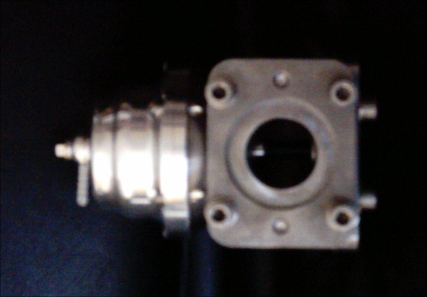

I dont want to put it on the car, looks absolutly lovely.
I am surprised how heavy it is, will have to try and fabricate some sort of bracket to support it, i am not sure about having something that heavy just clamped to the exhaust...

Are they the type that allow the TiAL to run in dual port mode, with one pipe going to the top port, one to the side, and the third coming from the banjo on the intercooler pipe?
I assume so as they have 3 connections, 1 from the banjo bolt and I think one to each WG port , But I don't have a confirmation yet.

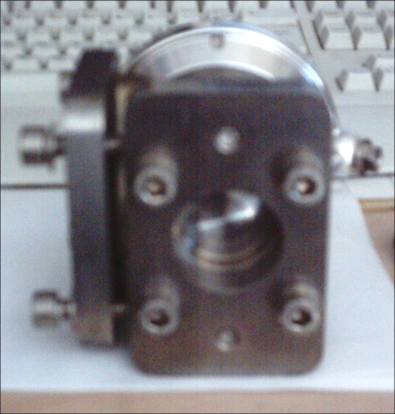

Mine does lean towards the back, and the engine side is at the bottom with the exit from the side.
You better check yours while you are doing it today Tony, and I'll await redfaced []
My earlier pics do look like the plates are fitted the same as yours
Anyway with the exhaust able to push it open (as delivered input on bottom) it makes sense to use the top port to hold it closed - I posted on rennlist this morning about combining an MBC and a reliaboost.

I found a few threads on Rennlist all querying how to install a TiAL. This is the best one and has a number of pics of different peoples wastegates (yawn)
http://forums.rennlist.com/rennforums/showthread.php?s=&threadid=122623&highlight=Tial+and+picture
The bottom of the TiAL does face the inlet (engine) and the side port is the exit down the exhaust. This is completely opposite to the standard WG and means it leans towards the rear of the car as opposed to the front like the standard one. I believe the bolts have different spacing so you can't install it incorrectly, but I can't exactly check that now - over to you guys with shiny wastegates in your hands
So this means that we were mistaken in our belief that exhaust pressure cannot open the valve prematurely. It can, because even though the TiAL valve opens inwards it makes no difference because it's mounted opposite

Dont forget it will take alot more then 0.8 bar or whatever you spring is rated at to push open the valve as the surface area is much much smaller, about 1/4 atleast of the diaphragm. So it will take about 3.6-4bar to open it, and i doudt you will be able to get this much pressure anyway...
