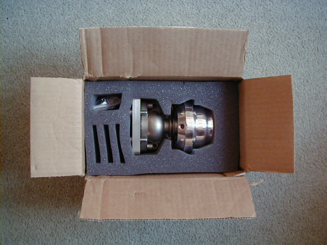

Just got mine, Fedex delivered it a few mins ago.
Boy does it look nice, what a shame to mount it where nobody can see it.

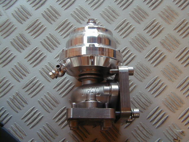

The wastegate itself looks incredibly well made, and is jolly shiny (wonder how long that will last [&:])
The Speedforceracing adaptor plates look very chunky and substantial and the bolts that come with them seem good quality. One thing to note is that the adaptor plates are only loosely bolted on so make sure they are nice and tight before installing. Also remove the eight mounting bolts before tightening the plates to the wastegate as they interfere if left in place. All the bolts need a 6mm allen key socket

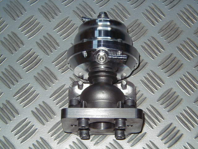

The wastegate comes with two banjo bolts, one for the side port and one for the top. Look closely at the banjo before installing because you have to align it correctly or no air can get through. This is difficult to explain, but when you see it you will know what I mean. I marked my banjo bolt with two black marks showing where the hole lines up (See pic below). I purposely misaligned the top bango bolt so that no muck can get into the top chamber. John was a bit worried about this, but this seems a neat solution [:)]
Before installing to the car I attached a line to the side port and a foot pump to see at what pressure the valve opens. Using this highly inaccurate method the valve opened at 12 psi (I have the 0.8bar spring)

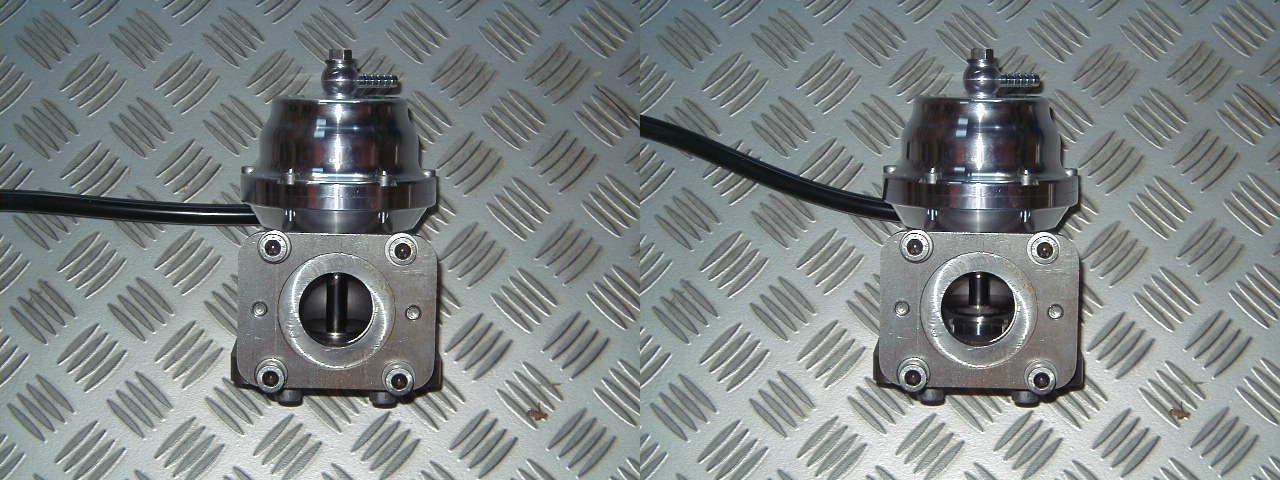

This pic shows the valve closed and open, note the difference to the standard wastegate in that it opens inwards and can't be forced open by exhaust pressure alone.
Isn't the top chamber supposed to be open to atmoshpere? I'm not saying it is, but I wonder if it is.
Edited by Paul You might be right, I think I will contact Tim at SFR to be sure, but the valve does still open ok

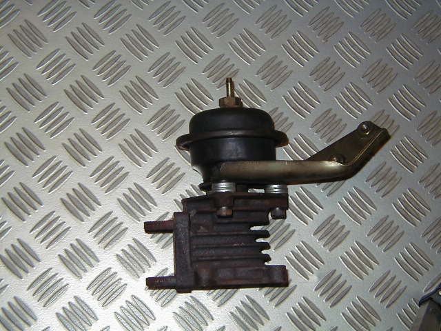

My cruddy old wastegate with many shims came out very easily (pic below) because I've had it out a couple of times before and used new bolts covered in copperslip when reinstalled.

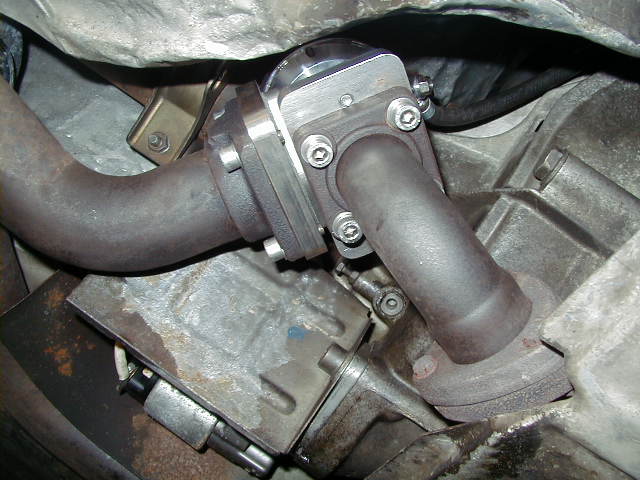

The TiAL did not slot straight into place. I had to loosen a few more bits and pieces to get it into place because it is a little bigger. One was the upper bracket for the old wastegate that is on the torque tube (this is not used by the TiAL), I just loosened it and slid it towards the rear of the car.
The other was the exhaust pipe that leads to the cat, or silencer if you have no cat. With this loosened it could swivel out the way so I could get the TiAL in place. At first it seems that one of the SFR adaptor plates is 2mm too thick, but with all of the 8 bolts loosely in place I gradually tightened them and it all lined up ok - phew [&:]
.....and here it is all bolted into place and with the side port connected to my Reliaboost line.
That copper coloured bracket in the top left corner is the old support bracket on the torque tube that I slid towards the rear of the car
