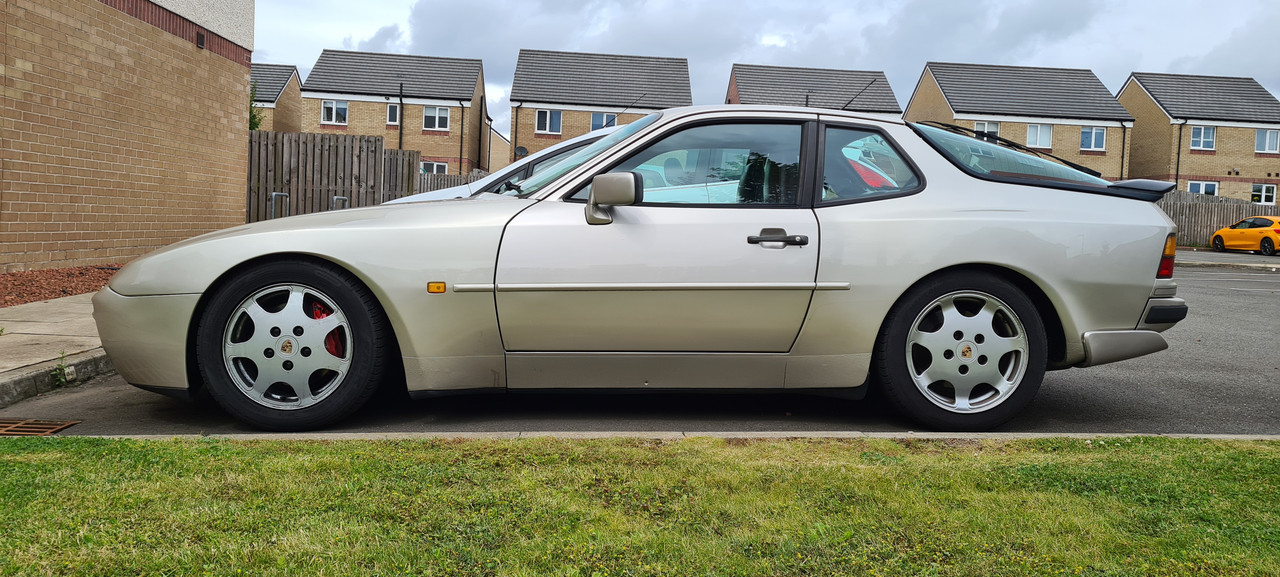

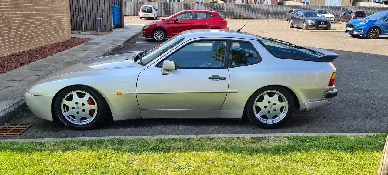

Got the front raised on Friday as planned as well as the geometry set-up. Car is now about an inch higher all round which is what I was looking for.
Before:
After:
The toe and camber were quite far out but that was expected after the shockers have been on and off, as well as a control arm when I done the ball joint. All good now.
There is no more adjustment left on the front, that's the GAZ units maxed out but I am happy where it is, so that is not a problem.
Stuart
That looks better. How does it drive?
Thanks Thom, I agree!
