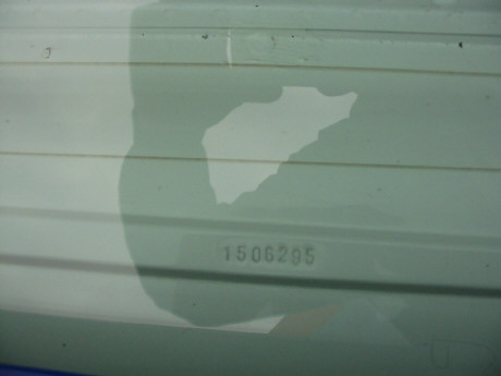

I checked a few shell nos at Spa. Mev's mine and Haki's(from email) all come from C2 production nos.
They are all in correct order for VINs to which is reassuring.
Ian's Cup and ex Des M003 cars had the RS series shell nos.
The shell nos are visible through the rear widow on the RHS. The engine lid, doors and bonnet all have the same shell no. stamped.
Porsche can give you a ipass with the shell and VIN nos so you can check the car has not been reshelled and or major bits replaced.
If shell nos are missing then it is likely the car has been tampered with but why would they do that.....?
This is why you need to inspect these cars before purchase.
Good to know (ex-Des = H____'s car now!). I am aware not all the panels (i.e. bonnet )are original.

My Cup car has a shell no., didn´t check the panelnumbers though. AFAIK they should match.
Rgds
Hacki
Hacki, just had a quick look at my M003 --- the number on the rear shelf (couldn't get to the under dash area) is a 7 digit number of which the last four digits are also stamped on the bonnet, rear engine cover and I understand inside the doors (couldn't get in there either).
This seven digit number is also printed on the top of the label under the bonnet --- in the format first three numbers, hyphen, last four numbers, but isn't printed on the label inside the service manual.
e.g. Shell number 1234567, top of bonnet label 123-4567, panel numbers 4567.

Thanks Charles,
And interesting that Ian's Cup car also has the later style RS mirrors rather than the earlier small Cup car mirrors ?
