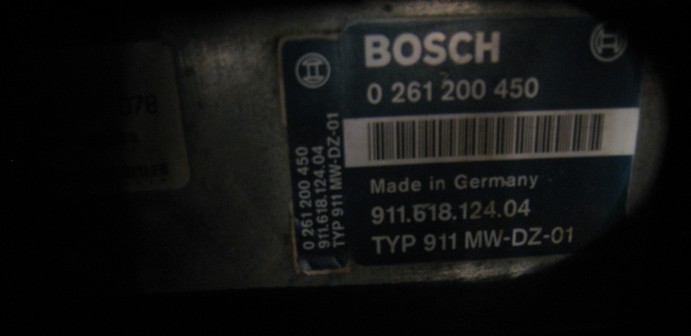

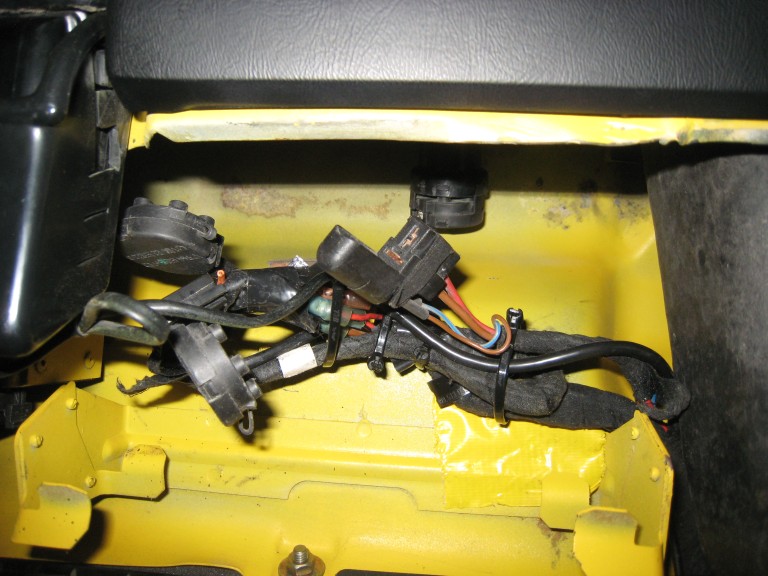

I checked out ZNS499174 today in my treasure hunt for a nice, affordable Clubsport. The more I saw the more questions came up:
- The harness (see pic) looked very unlike the one in my 964 RS Basis / M001. It looked rather like a C2 version
- The DME unit was located underneath the driver seat - instead of being mounted vertically behind the driver seat
- The roll cage had no number to it at all. It also looked as if it is not the regular N/GT version (second bar on the driver side, the cage did not reach all the way up into the roof but is welded in 2cm below the roof)
- the ABS unit was installed right next to the spare tire (i thought it should be sitting ca. 15 cm above the floor of the luggage compartment)
- No VIN sticker inside the bonnet, no service manual with a VIN sticker
- colour label missing
Dear Oracle, am I just to picky about everything ... or is ther something wrong with this car?
Please see also ze other pics
Klaus, I've been away and it's too late tonight but I'll take the same pics of my car tomorrow, ( assuming it's real ! )
I have Motec so I'll need to hunt out the original DME, but it should definitely be behind the drivers seat, not underneath it.
The roll cage should have a silver label on it with a Matter number ...
