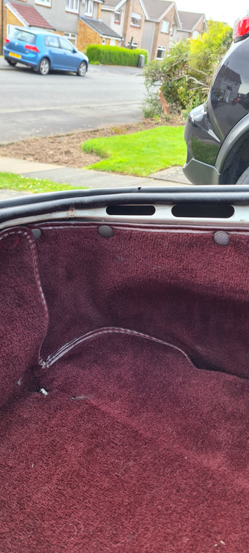

Our 1986 924S doesn't have rear seat belts at all,nor does it have the mounting brackets in the boot behind the rear seat back.
However ,it does have all the bolt holes but no holes through the rear squab so when I replaced the worn vinyl/fabric seat set a few years ago with a S/H grey leather set from a 968 ,IIRC, the new squab came with the belt apertures.
I bought a set of appropriate rear belts from James at Only 9 Spares from a 944 he was breaking,plus all the bolts & he obligingly cut off the 2 brackets but have yet to fit them.
Welding only entails 4 short welds per side -2 at the hatch side & 2 on the wheel well inner.

Fir tree clips in dark grey arrived. Decided against trying to colour them.
The 2 on the left are new and they look better than the original, faded, burgundy one on the right. £3.50 for 20 delivered.
