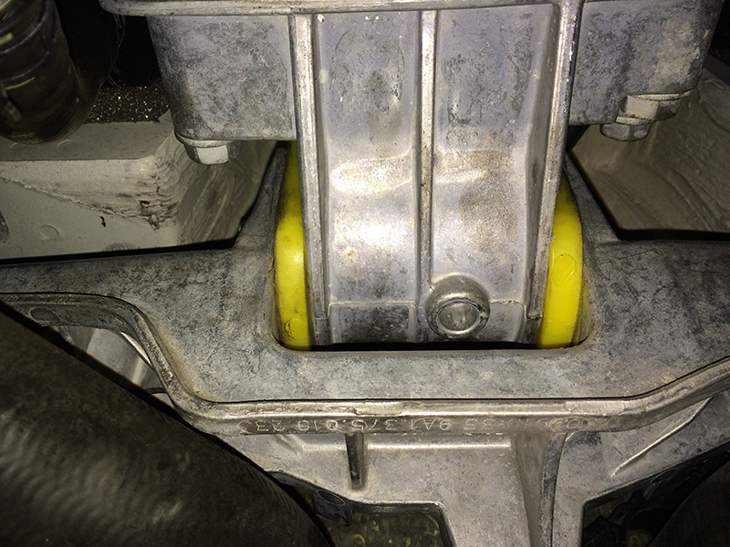

I run -2 for road and -2.5 for track with adjustable LCA, solid rear toe links and engine mount insert to stop that moving, cars very direct with no extra bad noises. This is on my Spyder btw but I run my R road only at -1.2 at the front. def worth doing on the R if you ever go near a track or are a fast road driver esp the rear toe links and engine mount for road only.ORIGINAL: TrackfanR I would love to see Porsche provide an increased provision for camber adjustment on the GT4. Like most track driving owners, I have maxed out the front slotted top mount adjustment on my CR and still only get a smidgen over 1 degree of negative camber. It's not enough! Longer lower track control arms would help achieve more front negative camber, as is fitted to the GT3. Anyone tried fitting GT3 track control arms on a CR? Porsche Motorsport Dept have plenty of experience of tweaking camber angles and ride heights, let's hope they get a go at the GT4.

I have a couple of the engine mount inserts for sale [ORIGINAL: MrDemonI run -2 for road and -2.5 for track with adjustable LCA, solid rear toe links and engine mount insert to stop that moving, cars very direct with no extra bad noises. This is on my Spyder btw but I run my R road only at -1.2 at the front. def worth doing on the R if you ever go near a track or are a fast road driver esp the rear toe links and engine mount for road only.ORIGINAL: TrackfanR I would love to see Porsche provide an increased provision for camber adjustment on the GT4. Like most track driving owners, I have maxed out the front slotted top mount adjustment on my CR and still only get a smidgen over 1 degree of negative camber. It's not enough! Longer lower track control arms would help achieve more front negative camber, as is fitted to the GT3. Anyone tried fitting GT3 track control arms on a CR? Porsche Motorsport Dept have plenty of experience of tweaking camber angles and ride heights, let's hope they get a go at the GT4.

I have monoball RSS rear toe links (fully adjustable for toe) to stop rear brake steer and help reduce rear wheel hop the 987 seems to have I also have RSS front LCA to allow camber ajustments more than top mounts, Doing the LCA also gives you wider front track which helps turn in. Also fitted are the RSS locking bolts at the engine side of the toe link. I fitted the boots to help keep the crap out as well.ORIGINAL: MotorheadBy solid, do you mean non-adjustable MrD? Discuss... JeffORIGINAL: MrDemon I run -2 for road and -2.5 for track with adjustable LCA, solid rear toe links and engine mount insert to stop that moving, cars very direct with no extra bad noises. This is on my Spyder btw but I run my R road only at -1.2 at the front.
