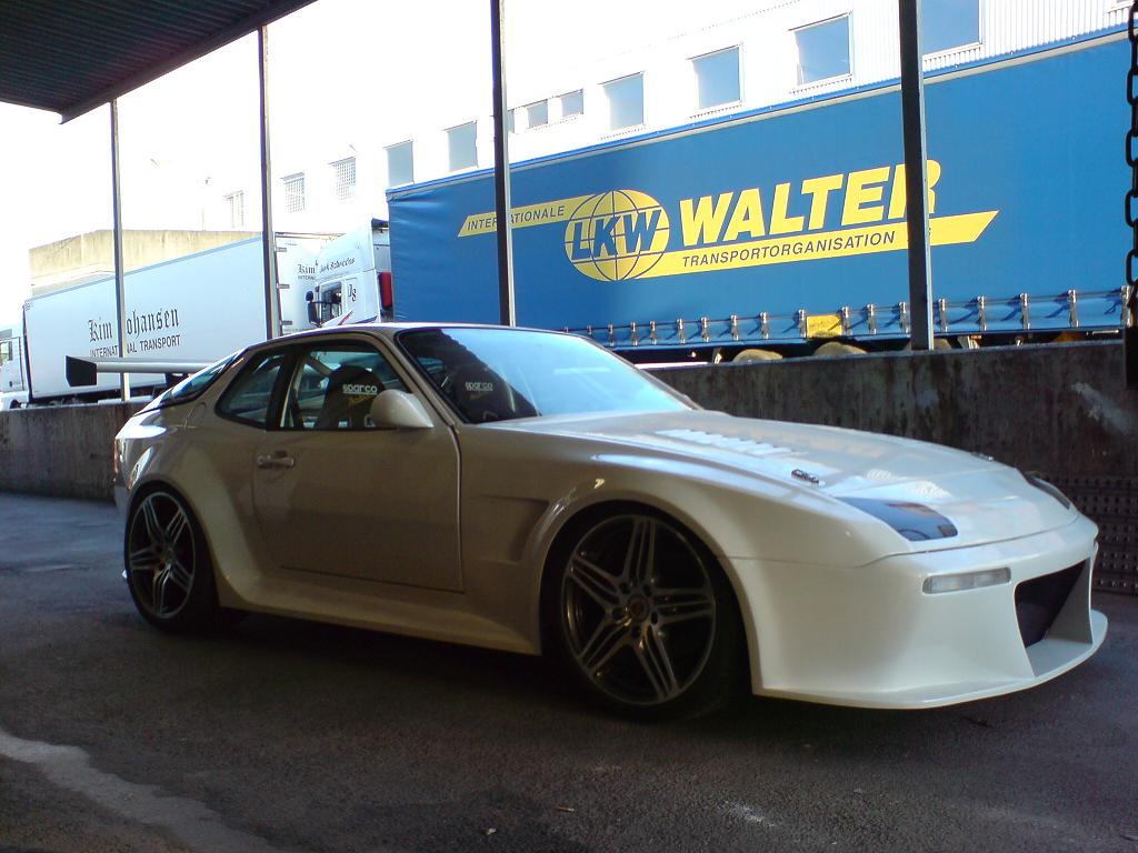

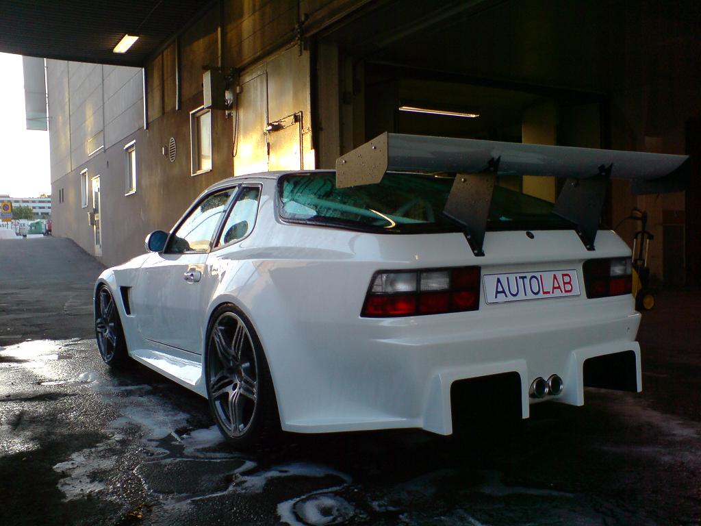

I actually don't think the Swedish one looks too bad either - I guess quality of workmanship makes a lot of difference. I wouldn't want ti myself, but it doesn't look like a 944 that has driven through Ripspeed like the other one does. I hope its owner never gets hold of a 911.

The good thing about the White car that I posted is that I wondered about a wider body kit that was more like a 930 type rear wheel arch than our hourglass profile. I now know that I don't like it no matter how good the workmanship is. However I do admire it for the obvious quality. From what I understand, this belongs to a shady character in Sweden who has probably funded this with dirty money. So I guess crime does pay but not neccessarily account for taste. []
