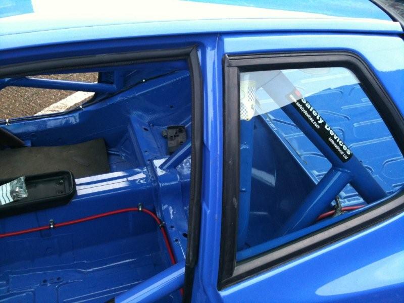

Something i have been working on!
Hi Mike,
Yup kept the electric windows and going to get the air con fixed aswell!!

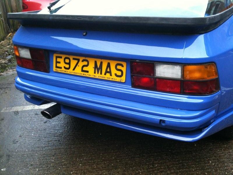

Looking fantastic Mark! You need a set of split-rim BBS's with gold spokes now! How has the rear bumper been lightened? Will you be able to give us an idea on costs for a complete strip and respray?

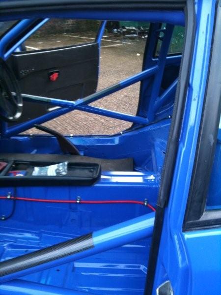

Good man. We decided to keep the electric windows, we worked out we could ditch everything else from the door and cut the door wiring right down to just a couple of wires for the window mech. I don't think Kev had tried this before because when Barry explained what we had done kev was fairly surprised to hear that the window switches sit nicely back from the cage, and the weight stripped down is barely anything at all. In fact ISTR Barry said it wasn't even worthwhile weighing the wiring that was left so the only difference is the tiny amount of the motor. Having done it I think its only worthwhile going to manual windows to save that last pound or two. For a start you can't even actually wind the window up and down as the manual winder doesn't clear the cage, so you can only pop the window up a down a little. For you and me Mark we can wind that sucker all the way up and down.
If you can you will save a lot of weight of the front end with a FG front bumper and FG front panel to ditch the headlights. ISTR we measured a total saving off the front end of circa 40 Kg compared to a complete stock front end, and this doesn't include ditching the PAS etc. If you have FG bonnet and wings that saves about 3Kg per wing + about 8Kg from the bonnet for a total of 14Kg. Removing the fog light units and fitting a pair of Ring running lights will save a fair bit more.

I like those door cards a lot, much better than my flat ones.
P.S. I still say opening windows are for girls [;)]

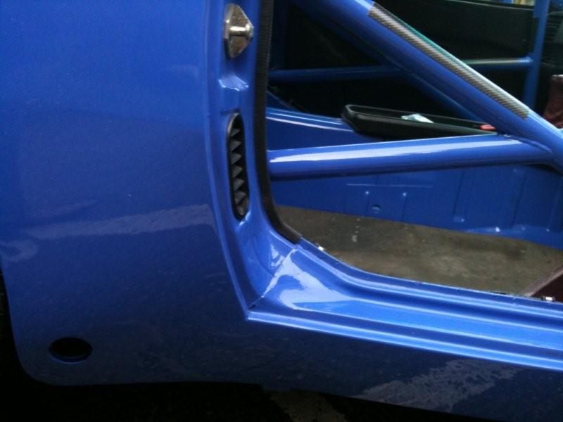

Fixed windows are better and safer (as theyre usually PC). An intake and hose from the rear quarter will provide more than enough fresh air on the hottest of days.

The car is going to be road legal and i need the windows to be able to pay tolls etc, the aim is also to have air con working so the car will be comfier on hot days.
Neil the front PU (and rear bumper) is a grp one, i would love some fixed lights(like mr Empsons) one day when budget allows to make the saving over the heavy pop ups, (plus they look really cool)[:D].Was great to see the car today its taking shape now,next time i see it i should be taking it home!

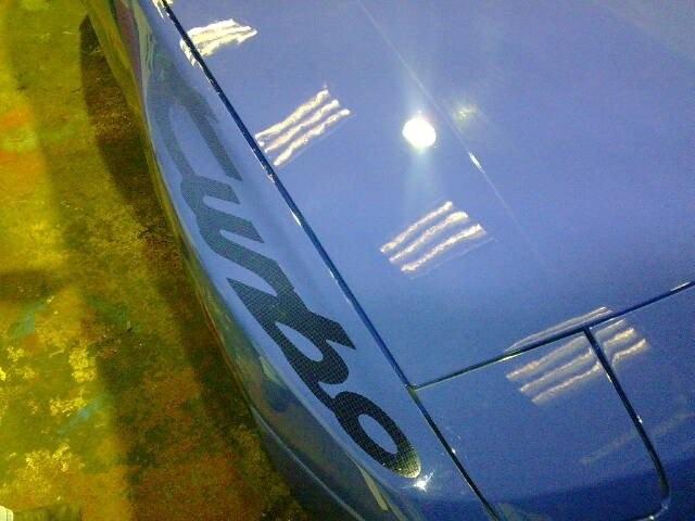

The turbo badge is on now breaks up the blue[:D]
