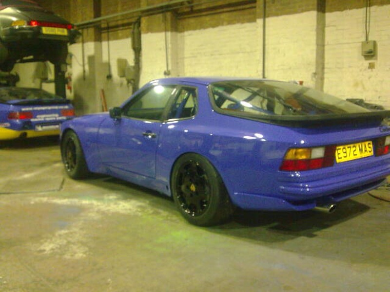

Something i have been working on!
Its sitting on its wheels![:)]
Wow those wheels are spaced out!
Have they already fitted the GAZ, it looks jolly low if it is still on the original M030?
Id say 'fitted'. Do you see the 60mm hole ahead of the rear wheel? Thats an access hole to allow re-indexing of the rear torsion bars without stripping.
Mark; Id be extremely interested to know how wide the spacers are on the front, and what the offset is of the wheel fitted (and its width).

Thanks guys[:)],yup the GAZ coilovers are fitted and the front will be dropped a fraction more,the wheels are the original fitment forged clubsports(which i love) sporting a new gloss black powdercoat finish with colour matched crests,the spacer kit makes it look a little fat but thats what EMC racecars cars look like from the selection i have seen,there was an S2 in white the other day sitting pretty much as low and fat,i looked at it and hoped mine would look the same..[:)],apparently it is a good way of killing understeer.The hole we decided to go ahead and drill in the sill for adjusting the rear rideheight was posted a while back in a photo,we are looking for a suitable tidy way to bung it up for everyday..
The seats and harnesses are going in shortly plus a couple more jobs to do.Got to say i always steered away from the spacer thing but i really like it with the black wheels.Turbo badge at the back is a bit low..
[8D][8D]Lovely, my favourites after CUP 1`s BUT be careful. I have heard tales of these failing under extereme conditions as they are prone to fatigue cracking with age.
I seen a pic of spokes breaking on the front wheels (the spokes do look thinner on the front wheels),i will just keep an eye on them and examine them on the inside especially if the car has been bouncing on kerbs etc,but i really like them,they suit the car,were free with the car and the tyres are cheaper[:D].Just really like the way these cars drive on sixteen inch wheels aswell.

Thanks,glad you like,thing i can't wait to experience is what it feels like lightened of so much,it felt grunty as hell for a standardish car even with all its heavy standard trim, so with less weight it should be good fun and very rigid,its D day either this week coming or begining of week after.....can't wait
