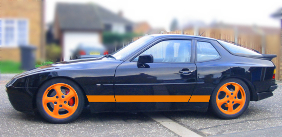

I rather like the side decal and think an orange "Turbo" version with matching orange wheels (9" all round [;)]) might not look too chav on Beaky. I've not mentioned this to Belinda yet. [:-]

Had a go with the orange wheels and decals. Belinda spotted it and went "Yuck!" (I think that's what she said) so we won't be going that route then.
Well that must have been where I got the idea from then [:)] Thought it was too cunning to be original!
I didn't think I'd like the orange based on the thumbnail, but the full size pic is nice, add an orange roll cage and seat backs and it'd be perfect.
I agree it does need the full GT3R treatment. Orange would look particularly unpleasant with a beige interior. [:eek:]
black carerra's with polished lip and silver graphics?? or replace/re-colour the interior add a black or polished lip to the wheels? i reckon you could go a bit racy, rs door cards, painted seat backs, remove the dash plastic and get it professionally sprayed in orange, coloured dials with chrome bezels.. what's not to love?
