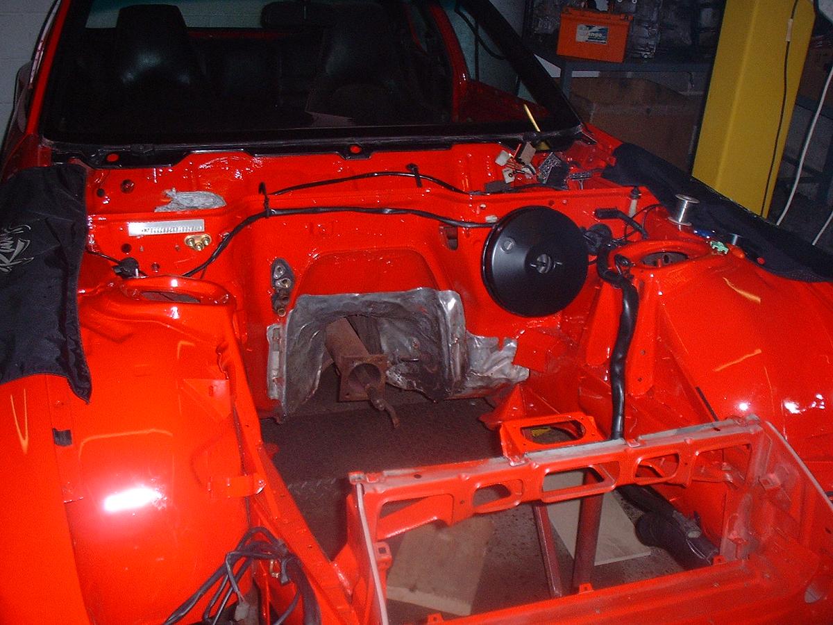

I am building the engine at the moment, a 2.5l with nickasil type bores and it will have the prototype all-Garrett ball bearing turbo, should be a nice package similar to my last 'torquemeister' car!
At the moment the car has no dash fitted, during its life it had been fitted with no less than FOUR alarm systems! As I was removing them I noticed a couple of wires with the insulation melted off in the main loom, from below the fusebox which runs up over the heater A/C unit and to the column area, I couldn't risk leaving them in the loom in case they shorted out some other supply, so bit the bullet and dissassembled the loom and replaced the two offending wires with correctly colour coded wires. nice....
I figured I would leave the dash out until the engine is installed and running so if I have any wiring issues everything is still open to facilitate fault finding.
Engine should be finished next week (famous last words) and then the car needs a couple of weeks to finish off, has still got an MOT, needs tax, running in etc. etc....
I am looking forward to having a 944 on the road again though, have been driving a 996 lately which is nice but somehow 'different'

p.s your first picture seems to be leaning a bit, maybe an alignment is in order
