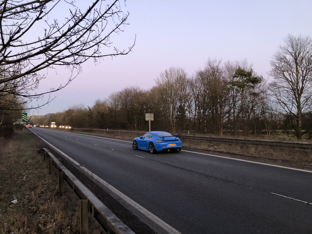

I've just returned home after an unsuccessful trip to Thruxton for a track day tomorrow. Approaching a traffic accident some quarter of a mile away and joining the queue of traffic, the engine just stopped with electrical power warnings. It wouldn't crank and I was in the outside lane of a normally fast section of the dual carriage way A303 west of the A36 junction. I had Stop/Start turned off as usual.
Warning lights on, yellow tabard on, put the red triangle out some distance behind the car - amazing how many drivers want to stay in the "fast" lane before pulling over. Luckily for me the accident ahead meant slow traffic coming past me so a lot safer than normal speeds. I get over behind the barrier and tell those who stop to ask that it's an EV and the battery has died...

When you are stuck in a dangerous position, cross your fingers.. (taken at 18:05 when most traffic is East/West but West/East just see a nice clear road...)
