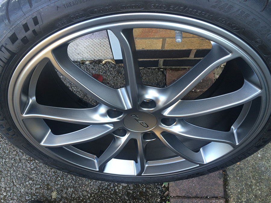

Cannot always be driving, so took the 2 front wheels off and gave them a very deep clean and finished off with the Gtechniq C5 Wheel Armour coating for future easy cleaning.
people say it last 20k miles !!! lets hope so at the price of the stuff.
